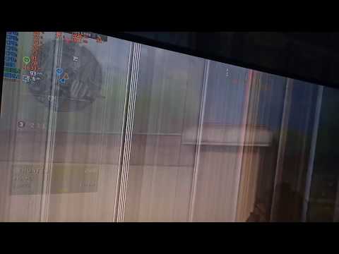

2 years ago I was lucky enough to buy an Acer monitor. After a few days of use I started to notice strange flickering when using the monitor for a long time.
This is how the defect looks like
At first I could not understand anything. The defect may not appear at all for weeks. Especially if you do not use the monitor too much (an hour or two a day) and reduce the brightness. And by the nature of the artifacts you can think that it is a problem with the OS, the PC hardware or the cable. Started checking the whole thing. The same thing happens with HDMI instead of the complete DP. Tested at 120Hz. With overdrives and FreeSync turned off.

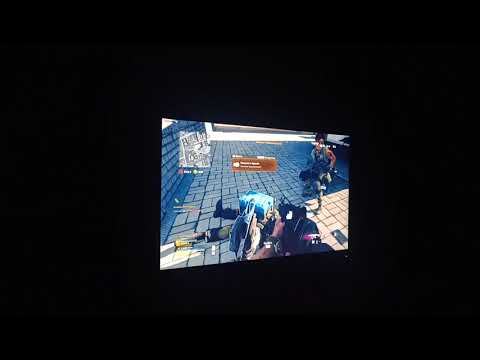

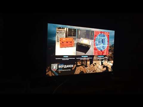

I managed to take pictures. I took pictures on the PC a year ago. Now checked on the console to rule out a malfunction in my configuration (although already changed completely in a year, and the defect remained).
Here are my videos form PS5:
https://youtu.be/sDW9U3zBaqc
PS5 via HDMI on 08/28/2021 for the first time
https://youtu.be/WDdeWZMnKQs
PS5 with HDMI on 08.28.2021 for the second time
There were more cases of the defect that day. Flickered 5 times in an hour or so. But I didn't record everything. There are more complete uncut videos. You can see the console interface there.

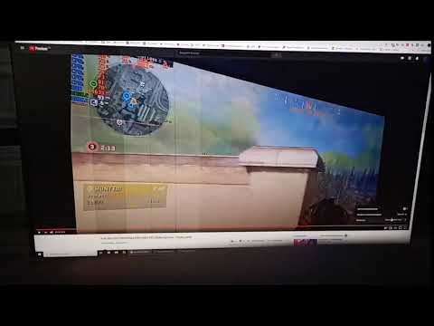

From PC:
https://youtu.be/azcaQEI_81s
One year's video via Display Port on PC
https://youtu.be/OjkkkUc__G4
One year old Display Port video on a PC in slow motion
