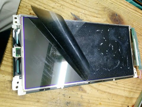

I have the monitor H243HX. Not used much and only cleaned carefully dry with a microfiber tissue. Recently it started to get waves on the screen - see picture. It is useless now. How can this happen?

    That almost looks like the surface has been exposed to a solvent that partially melted the surface. :(

    To the question if the waves appear when the monitor is on. They are on the surface of the screen. Recently some areas got grey and there the displayed content cannot be seen anymore. It seems as if only the glass got a problem. The rest of the monitor seems to be working normally.

    Here are the pictures. The first one shows again the waves on the outside surface. The last one was taken about a week after the second one. Now it has these grey areas. The picture also got more white. The monitor surface simply deteriorates. There is no warranty anymore. But it would be nice if Acer gives my an explanation how all this can happen.

    I think it is something that is called the vinegar syndrome. After looking very long on the Internet I learned about this yesterday. And yes, the monitor smells like vinegar. The polarizer dissolves itself. It is possible to repair this if you find someone that would do this strange repair. At Acer they for sure will not do something like this. The best fix is to throw it away. And you have to be careful. I put my Acer notebook in front of this monitor. The gases from the bad monitor can start the same reaction on the display of the notebook monitor. Here is a link to YouTube that explains all this.
