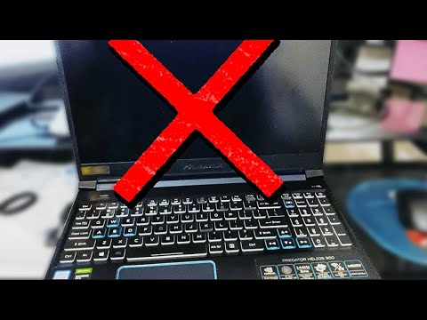

  • In the description of this video, there is a possible solution:
