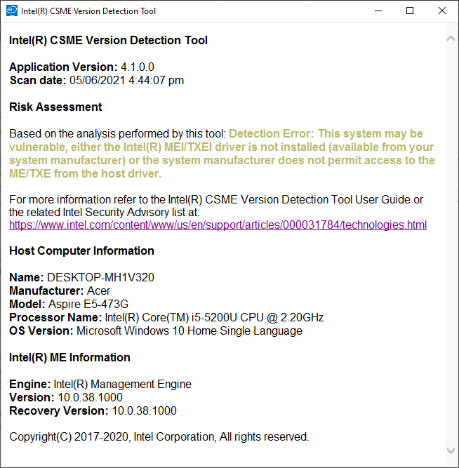

Moreover, I tried using Intel CSMEVDT and received the following risk assessment:
According to Intel:
Q: My system is reported as may be Vulnerable by the Intel CSME Version Detection Tool. What do I do?
A: A status of may be Vulnerable is usually seen when either of the following drivers aren't installed:
Intel® Management Engine Interface (Intel® MEI) driver, or
Intel® Trusted Execution Engine Interface (Intel® TXEI) driver
Contact your system or motherboard manufacturer to obtain the correct drivers for your system.

    Thanks for the replies, JackE and egydiocoelho.
    JackE Yes, there are yellow warnings for PCI SCC and SM BC. I have actually tried installing the chipset driver from the product page before posting my question. I'm not sure if that was the reason but the SM BC was gone from Other Devices in Device Manager (I guess it moved to another device category and lost its yellow warning / Code 28 status). However, PCI SCC still has Code 28 status despite attempts to reinstall it.
    egydiocoelho I guess this downgrade is to force Windows/Intel DSA to update the drivers? I have installed it but PCI SCC still has Code 28 status. Intel DSA also still reports "No supported driver or software updates are available for [my] system."

  • spponcian
    spponcian Member Posts: 3 New User
    JackE said:
    Download and install iobit's DriverBooster freeware to see if it'll pick up anything on line.
    I was able to update that specific device (Intel MEI) through DriverBooster. Thanks JackE!
