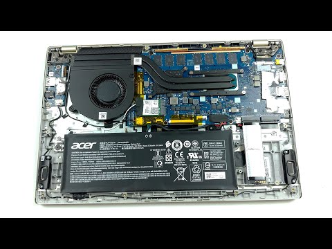

    Does the display also flash when you access the bios? If the display also flashes on the bios, there may be a problem with the edp cable or the display itself. Sometimes, disconnecting and reconnecting the edp cable can solve the problem:
    https://www.youtube.com/watch?v=7-kKAFeX-A0
    https://youtu.be/7-kKAFeX-A0
    First, disconnect the battery:
    Then, disconnect and reconnect the edp cable:

  • In my opinion, the edp cable may be poorly connected. If it was my laptop, I would disassemble it and put high-strength duct tape on the edp cable connectors so the cable doesn't move or disconnect.
