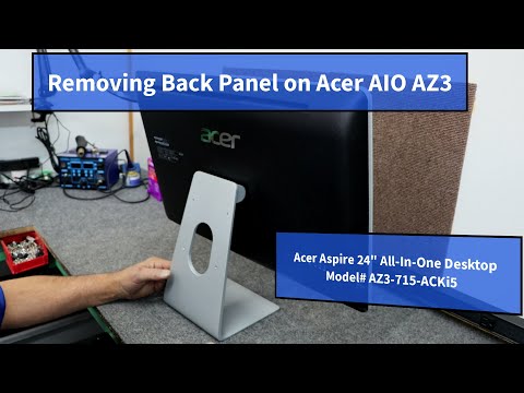

    The only thing that worked was to crack the machine open, remove the hard drive, put the hard drive in my other machine:

    https://youtu.be/n8VGIXzG-so is where I found how to take back panel off.
    If the forum doesn't like me linking to youtube just search for "acer aspire z3-710 disassembly" in the Youtube search bar.
