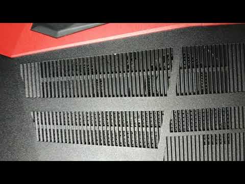

Hi, today I was replacing the paste and cleaning the cooling on my Acer Helios 300 laptop.
 After twisting, I fired the laptop and the fans do not work when the temperature rises, but they only turn on and off every now and then. In the PredatorSense application, they do not react to the set speed and it is still written 0 RPM. Anyone know what it could be?
  • Grom98
    Grom98 Member Posts: 3 New User
    This is how it looks like
