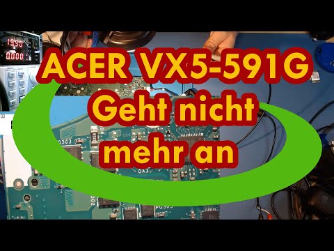

  • I found a video in German, in which the problem is very similar, see:
    Of course, the problem may also be elsewhere on the motherboard.
                                                     egydiocoelho Trailblazer
  • jeffrimko
    jeffrimko Member Posts: 12
    Tinkerer
    Thank you very much for finding that video! It's useful to see how to remove the motherboard, I haven't tried removing it yet because wasn't sure if the heatsinks also had to be removed. I will take a closer look later today to see if I can find a damaged component.

    Haven't found a visibly damaged capacitor yet like in the video. Checked a few MOSFETs and found one that might be an issue, it has 19V on the drain and 0.2V on the source and gate. Checked this with the CMOS battery installed to make sure that didn't factor into the MOSFET turning on. The designator is PQ302, haven't tried putting a jumper around it yet.
