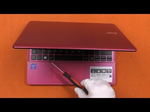

  • The problem is that the sata connector is soldered on the @aphanic motherboard, see:
    In addition, as the other hard drive was detected by the bios, it is possible that the user @Jalak just had to reinstall windows.
