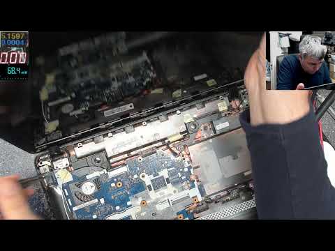

    The same technician fixed another model with a problem with the power button:
                                                     egydiocoelho Trailblazer
  • BillyGA
    BillyGA Member Posts: 8
    Tinkerer
    Thanks for the videos.  It appears I am going to have to go ahead and take my computer apart like the technician in the video does.  I am fairly confident I will be able to do it after watching the videos you referenced.  Hopefully I will be able to determine what the problem is when I get a look at the inside, especially around the area where the power plugs in.  I'll let you know what happens when I get inside, hopefully within a few days.  Too late for me to get started on it tonight.  Feel free to post more videos of that technician working on Acer laptops.  He seems to know what he is doing and he enjoys helping people, as you do also.

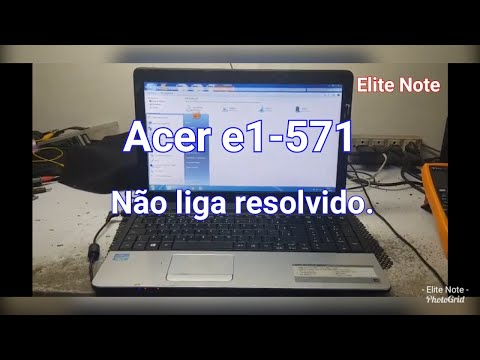

  • I found two more videos. But they are in Portuguese:
    You can use the English subtitles.
