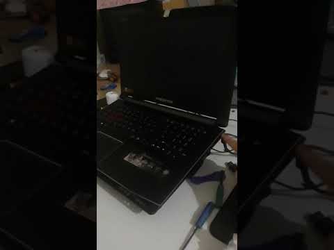

Link to the video of the notebook:
It turned off out of nowhere when I was playing a game, then it simple died all it does is this weird blink!

    I also tried again to:
    - Remove the battery, click power 60 seconds, replug it and try to turn the computer on.
    *Same result just a LED blink
    - Remove the battery, plugged the charger, tried to turn the computer on.
    *No answer from the computer not even the LED
    Makes me even more worried!
    (The charge was 100% when the computer turned of out of nowhere)
