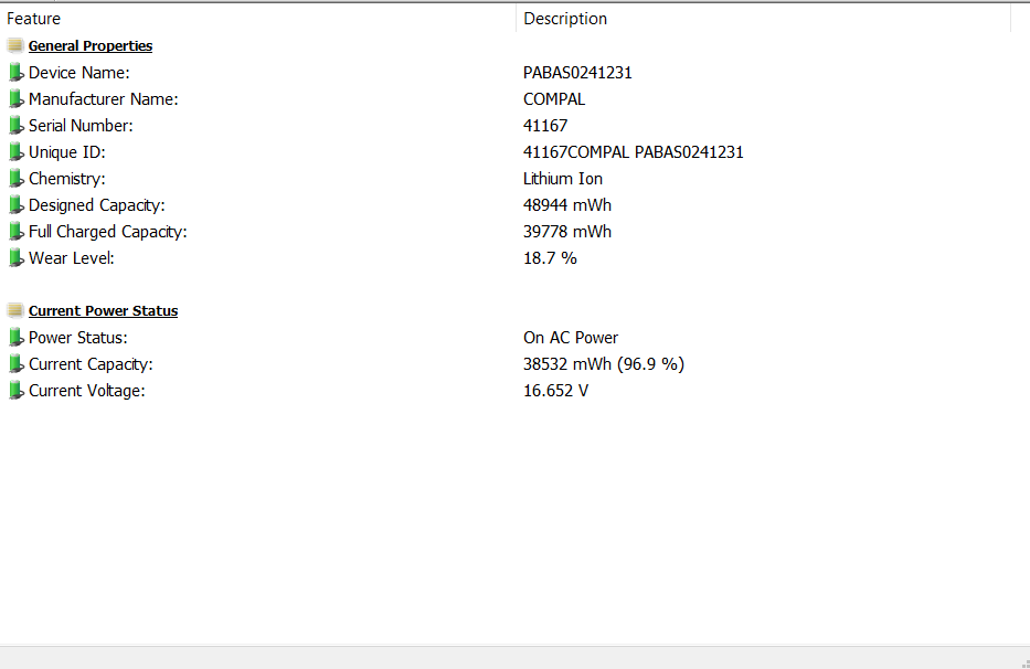

  • pinchdoodle
    pinchdoodle Member Posts: 4 New User
    edited April 2020
    Don't know if this is what you mean but here is the battery

  • andylb
    andylb ACE Posts: 3,827 Pathfinder
    edited April 2020
    Check your battery connector, reseat it a couple of times, your battery health looks ok acceptable wear
