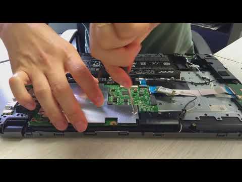

  • This yellow part got stuck in the dcin jack connector (charging slot)?
      egydiocoelho Trailblazer
  • zaya
    zaya Member Posts: 6 New User
    yes it did
  • Is your notebook under warranty? If not, open the notebook and disconnect the battery. See that the dcin jack cable is integrated into the motherboard and try to remove the part that was stuck in the charging slot with small tweezers. It is important that the notebook is completely turned off:
    https://youtu.be/fkG9dzj8xRc
