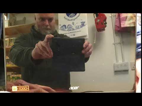

The 2018 (newer one) will not turn on and I cannot PowerWash.
I can get a message to flick up on screen for approx 0.1 sec that says the Chromeos is damaged and then the screen goes black
See https://youtu.be/IGeleOrkewA
    As the screen does not say on then re-flashing cannot be achieved and I have tried that re Google support answer
    https://support.google.com/chromebook/answer/1080595?hl=en
    Also I think that rather than it simply being a screen issue the chromebook is power-cycling, restarting after the message comes up.

    A bad battery could present as a startup followed almost immediately by a shutdown, but it wouldn't give the error message that says ChromeOS is damaged. That message would only appear when it is trying to load the OS and failing. You should be able to enter recovery mode if the problem is just a corrupted OS. You may be dealing with multiple simultaneous issues. :(
