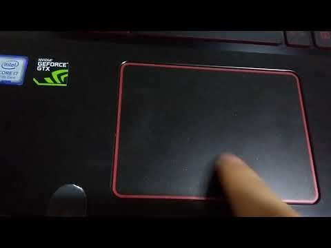

Recently this afternoon I was using my laptop when I noticed weird sounds coming from the touchpad whenever I lightly tapped it. I have had that problem before and when I sent it to bestbuy they changed the whole entire palm rest and touchpad. I also have a sibling that experiences the same sound with their touchpad just louder. It began as a weird loose like trackpad sound but then turned into a waterlike sound. Whenever I clean around the area by blowing on it. it stops for a short period of time, whenever I apply pressure to it, it stops until I release my pressure. Whenever I put it on my lap it stops completely. Does anyone know the cause of this? How is this stopped?

    is it a noise similar to this?
    https://youtu.be/txnxMr9q09Q
    Yes it is very similar if not exactly like it
  • There was a user here in the community, who had the same problem and put some pieces of sponge (I'm not sure of the correct name), under the touchpad, to reduce the noise
    Where do you put the sponge? Like over the whole touchpad? Also is it just any sponge?
  • Can you record a video of the problem? Also, is your notebook under warranty?

  • He put some layers of electrical tape here:
    Now, on the issue of the guarantee, I believe there will be no problems. But I suggest you check with technical support.
