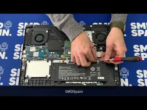

  • HasanGokce
    HasanGokce Member Posts: 1 New User
    My model: AC517-51
    Working solution for me:
    • Disassembly laptop cover with a screwer
    • Remove battery pin and put it again
    https://www.youtube.com/watch?v=wlcR2P1FNFc&ab_channel=SMDSpain
