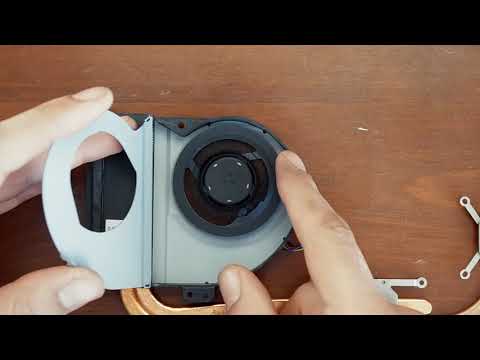

Its almost a year that i bought this laptop, and now the GPU Fan does not work, sometimes it work but not at maximum speed when i turn it to the max speed. I opened the laptop and cleaned up the fan, and i found that my fan does not spin smoothly as the other one. I want to lubricate the fan but i did not found any screw hole or pin to open the fan. Can someone tell me how to open it?

    The video below is for repasting and fan replacement on a Nitro model almost identical to yours, if you follow it you will get access to all the fan components and while you are there it wouldn't hurt to repaste with Grizzly Kryonaut for improved temperatures.

    That's was not helped me, its a common thing, i already do that. That's just replace the fan with the new one, when i'm trying to lubricate the fan, but thanks for helping.

    I understand that the video doesn't show you how to lubricate the fan, I posted it so that you could tear down to the fan then work out how to lubricate it yourself

    Typically the fans have sealed bearings, so no lubrication possible. It's much better to just replace it with a good quality fan the same size.

    https://www.youtube.com/watch?v=XZI_uJ1Y03A&t=171s this will help you

    I'm using the Nitro 5 AN515 54, and had the same problem with u. With the fan, when small screws are removed, just basicly flip it back and pop the properller out from pushing it directly through small holes. It requires quite much effort tho. Hope my experience could help u brother.
