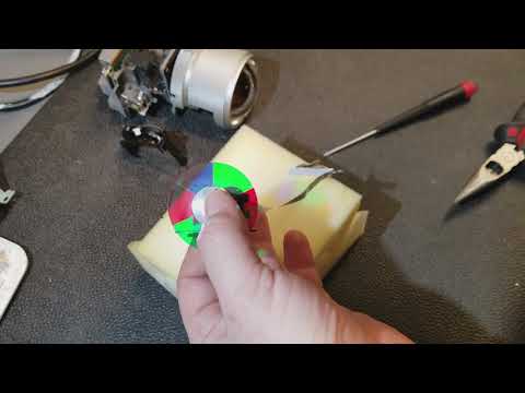

    I could finally fix my problem by cleaning the sensors of the color wheel. For doing this procedure there is no special knowledge of electronics needed, but it can still be a bit tricky to disassemble the projector until you can reach the sensor (and there is of course always the danger of destroying something)
    The following links helped me a lot:
    https://theartofsound.net/forum/showthread.php?38735-Flickering-colours-on-a-DLP-projector-after-warm-up
    (the 7550BD is nearly identical on the inside. Fortunately I was able to losen the screws on the side of the color wheel without the necessity to dismount the circuit board. Some patience was needed, though)
  • PercyPerceePercyPercee Member Posts: 3 New User
    And this link could also be helpfull to find the sensor after dismounting the color wheel:
