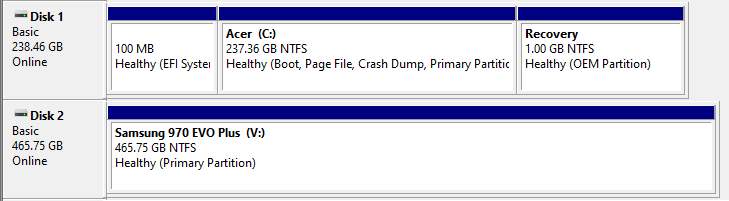

Here is an image of diskmgmt.msc showing original SSD with recovery partition and new SSD:
I’m not sure what to think about sacrificing the recovery partition.  It’s there for a reason, isn't it? It comes pre-configured with all the ACER drivers I need.  While it’s possible to recover/reinstall Windows 10 from generic Windows boot media, it won’t have all the manufacturer’s drivers preinstalled, so generic Windows installations might require a lot more work mucking around…?  I’ll assume this is not a deal-breaker for the moment.

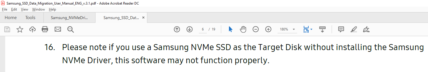

Also from “Samsung_SSD_Data_Migration_User_Manual_ENG_v.3.1.pdf”:
“16. Please note if you use a Samsung NVMe SSD as the Target Disk without installing the Samsung NVMe Driver, this software may not function properly.”
*may not* ???  I could really use some help interpreting this because I’ve found this driver impossible to install, and I’m not sure of the consequences...

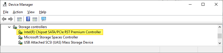

The factory default setting for the Predator PH517-51 is with RAID mode enabled, which is peculiar because the OS is preinstalled on a single SATA M.2 drive that isn’t a part of a RAID array, and it appears to be interfering with the NVMe driver installation.

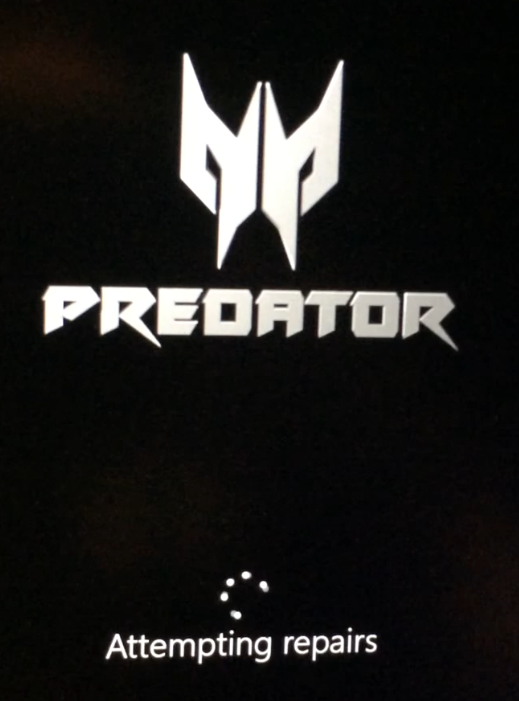

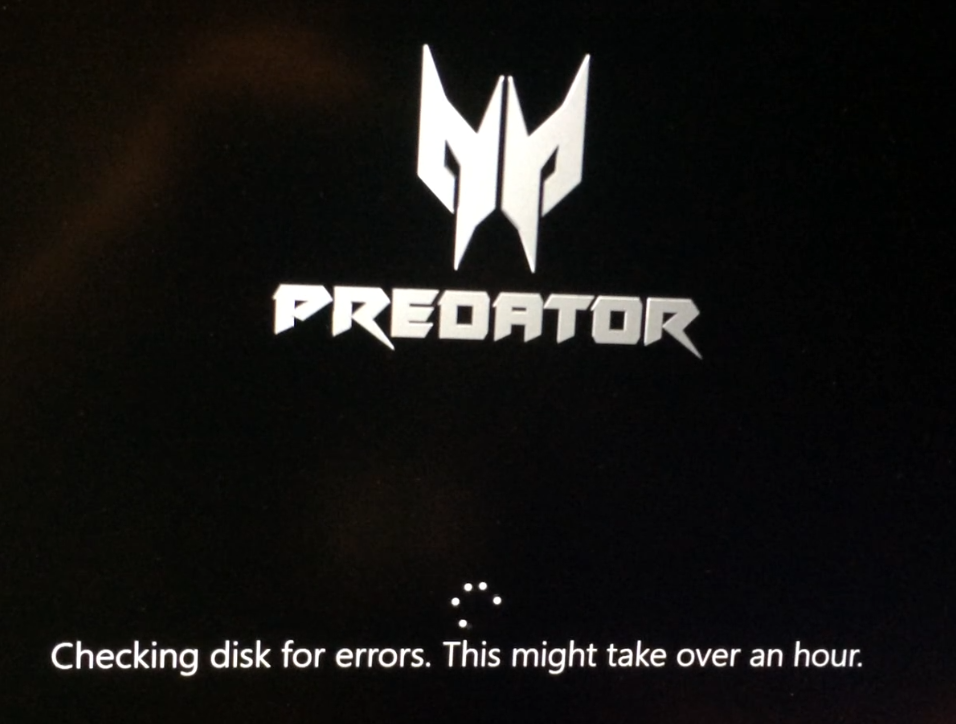

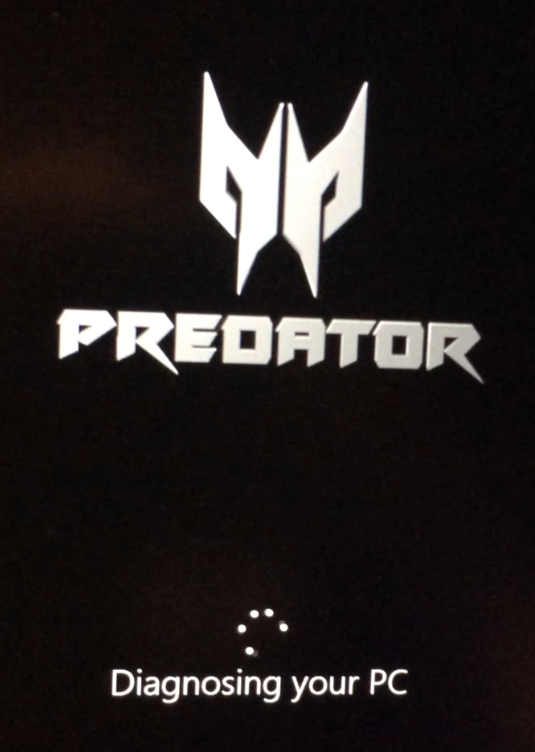

I have no desire to RAID my two M.2 drives, so I tried turning it off in my BIOS by changing SATA mode from “RST Premium with Optane” to “AHCI”.  This resulted in 20 minutes of rebooting and troubleshooting with messages such as “Diagnosing your PC”, “Checking disk for errors. This might take over an hour.”, “Attempting repairs” all to no avail. So I had to go back into my BIOS to revert SATA mode to “RST Premium with Optane” from “AHCI”.
So it seems like I’m in a ‘chicken and egg’ scenario:  Windows requires the NVMe driver to be installed before switching BIOS to AHCI mode or it won’t boot, and Samsung NVMe driver installer requires the device to be recognisable as a NVMe device (through BIOS AHCI setting) before it will install the driver.  So I’ve reached an impasse with ACER and Samsung.
