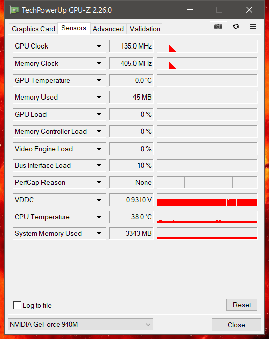

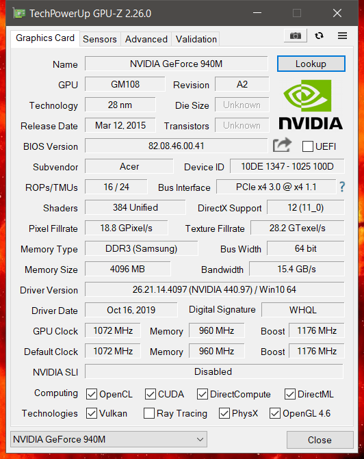

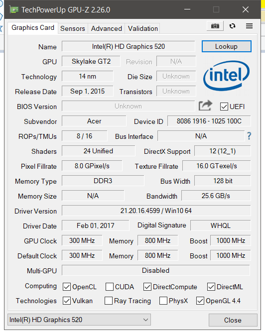

    I downloaded the program. Not sure what I am suppose to do or looking for. Here is screenshots of the two gpu drivers
    I still have Nvidia disabled.. Not sure if that matters.

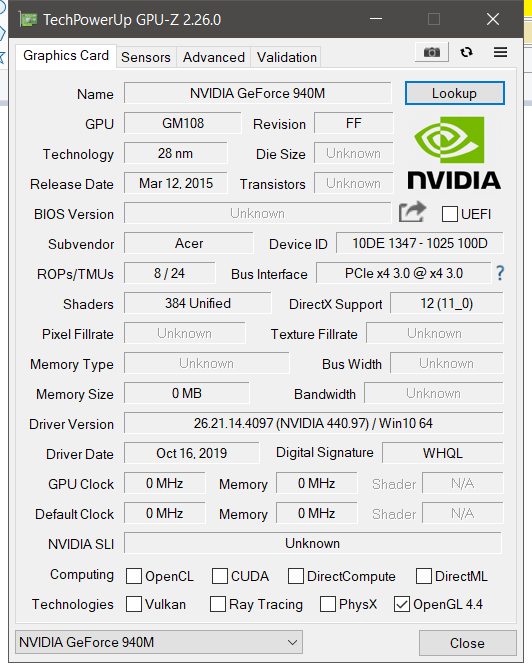

    I re enabled NVIDIA to see if anything would be different in GPu-z.
    Heres the screenshot with it enabled.
    Like I said , I am not sure what am I suppose to be looking for. I'm not the best with computers.. Does this mean it's a faulty GPU going out or what?
