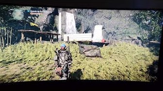

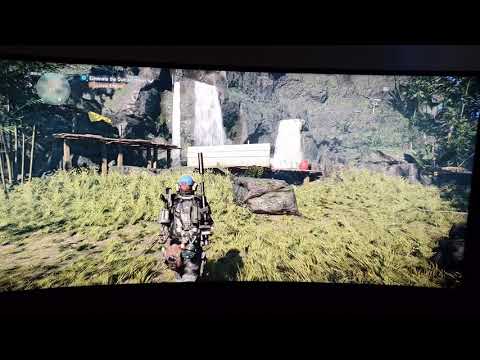

Have you looked at my videos Ive took of resident evil 2 remake on youtube? It shows you how to get the flicker to show in most games. Its blatently an issue. Its clear flickering in certain highly lit scenes with smoke/volumentrics. An issue is an issue; it doesnt matter how sensitive to the issue you are or even if you are fully concious to it, you might not even be noticing it but it still might be stressing your head and eyes out in the background making you tired. Its not supposed to flicker they have advetised this in three different places, they have highly designed electronics to ensure that flickering does not happen at different voltages/currents, and flicker in the range of even at 400hz would be picked up and seen as a fault. This flicker is able to be seen at 80fps plus. You keep infering people that do see this flicker are not seeing an issue. But overwelming evidence would show that they almost certainly are seeing an issue. We have all bought this very expensive monitor. You need to just play a HDR title for a while around smokey enviroments with overdrive on extreme. Sometimes 50% of the frames have either flicker or lines. Im actively trying to ignore them. Reviews have stated the issue, people have went into shops and seen the issue, people on here have captured the issue. Its indesputable and incontravertably an issue. Theres been no denying that it is an issue from acer and theyve had ample time to do so. Contary; Theyve said they can reproduce the issue. If you keep telling people on here the issue they are having is not an issue they will get frustraighted and this will carry over in thier responses and its obvious this is what it going on here.
Thankyou! people need to stop saying that this isnt the monitor's fault. Its very clear in my video:

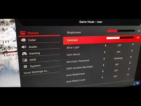

On my x35, when I open this picture, it's flickering with contrast 46 (overdrive Normal). With contrast more than 46- just scanlines, with contrast 45 and below no flickering or scanlines.
It flickers even at 0 contrast on my PG35VQ max contrast flickers too, Normal overdrive. 144hz
you may have to play with zoom in and out of the img to make the scanlines appear after you change contrast. Try it with below 46, they will be back!
Also you have to close the OSD for scanlines/flicker to show up. You move the image after closing the osd and try different zoom levels.

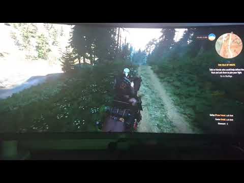

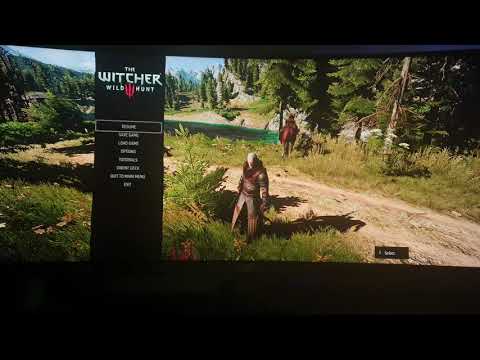

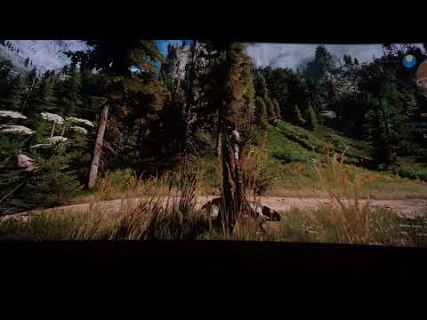

I just tried Playing Witcher 3 after so many years....nah...I get where you guys testing witcher 3 are coming from .. there is no way Acer/Asus/Nvidia cant see this..

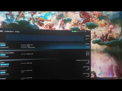

I have asked PC monitors about this issue : Steam downloading bars flickering.
Apparently it is normal because its the slow pixel response rate thats causing the steam flickering. So even if The bigger scanline/flickering issue is fixed I dont think the slow pixel flickering would ever go away...
can anyone with another VA monitor confirm this ? does your steam downloading speed bar flicker when you move the window ?
i posted this on reddit but no one seems to actually test it. It happens with FALD off FYI. I dont see this on my LG IPS monitor.
So its prolly the slow pixel response that is causing flickering in Witcher 3... and it would still occur even after a fix.
but anyone with a different VA model could test the steam thing from my video we would certainly know if its VA related of jus an issue on this.

I can replicate the fault 100% of the time in PUBG.
On a positive note though, this one has a lot less black smearing. Still no good for gaming with the screen flickering.
