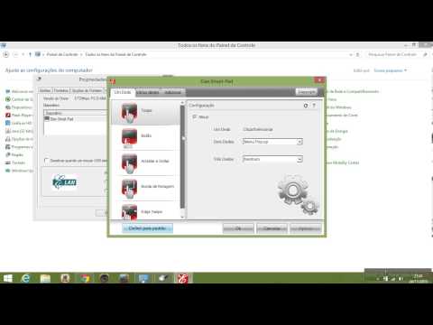

  • Check this video:
    https://youtu.be/i9CkgqDUuxs

  • Have you tried uninstalling and deleting the mouse driver? Here's an example:
    Then restart the notebook and test it!
