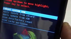

    Hi Try the below steps . Try for remove files and drive option. you will loose your data, so if you have important info->take a backup and then do the options.
    1. Power off your Tablet.
    2. Press and hold Volume up and Power button at the same time until you boot into the Android system recovery. ...
    3. Choose Wipe data/Factory Reset with your volume keys and then press the power button to confirm.Related image
