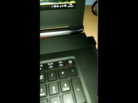

    Would it be a noise like this?

    I noticed that the BIOS update did not indicate that kind of update. But my point is I had that high temperature in the past year, but it never have that noise problem until a month or two month before. So I am kind of doubt the noise problem is caused by high temperature. Maybe it caused by the dust inside my laptop? I don't know. But I don't that skill to tease it apart without guarantee not to do something wrong and the local acer service center does not provide a cleaning service. So I think the best way will be change the setting to see if that will solve the problem.

    Dust can actually cause the noise of the cooler to increase! Could you record a video or audio problem?

    Thanks for replaying, egydiocoelho. It is not fan's sound. The noise is from the speaker itself, if I mute my laptop the noise will be gone. So I think it is not a fan problem.
