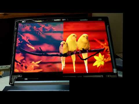

    I've made a video about the difference in color and contrast between the default panel that came with my A515-51G and the new panel that I bought and replaced it with. I put it up on YouTube if anyone wants to check it out.
    https://youtu.be/7Q3H_Mimcks
