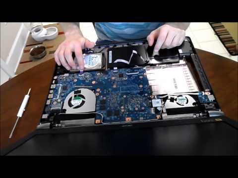

    I was wondering, could it have to do with the battery reset 'button' on the back?
    At several places this was suggested as a possible solution.
    When trying, however, I couldn't really feel a button that is pressed. Maybe something is hanging there, or is that not possible?
    How could I check? When opened, the 'button' is at the other side of the motherboard, so very difficult for me to check.
  • There may be yes! Something is pressing the battery reset button down!
                                                     egydiocoelho Trailblazer
  • vanderq
    vanderq Member Posts: 5 New User
    Thanks. Any tips on how I could check that in the best way, with the least amount of risk?
  • The only way is by opening the notebook, like this:
