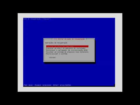

    On some other websites it was mentioned to use other usb bootable linux and reinstall grub after going inside my current Linux partition .
    If thats the case which linux i should download and use . Is there light linux which can do this or I need to download the same debian based linux I had installed .
  • Make sure this video can help you:
    https://www.youtube.com/watch?v=gj_uNxV3f0E
                                                     egydiocoelho Trailblazer
