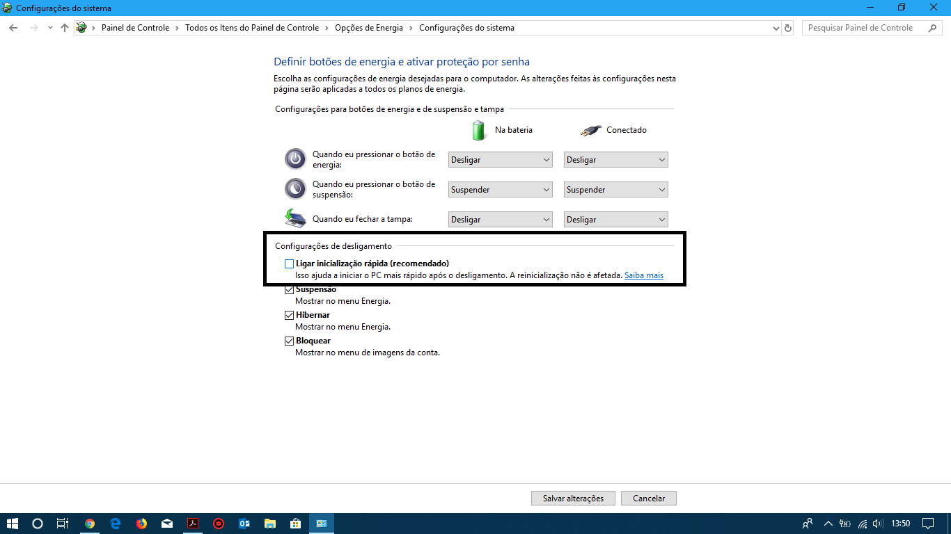

  • In addition to the tips of fellow Jacke, have you tried disabling fast start up?

    (1)  Uninstall Wifi adapter from Device Manager. Exit without installing anything.
    (2)  Uncheck fast startup box in Control Panel power button options to disable fast boot.
    (3)  Shut down
    (4)  Exchange wifi card with GDC adapter.
    (5)  Turn it back on and hope for the best
