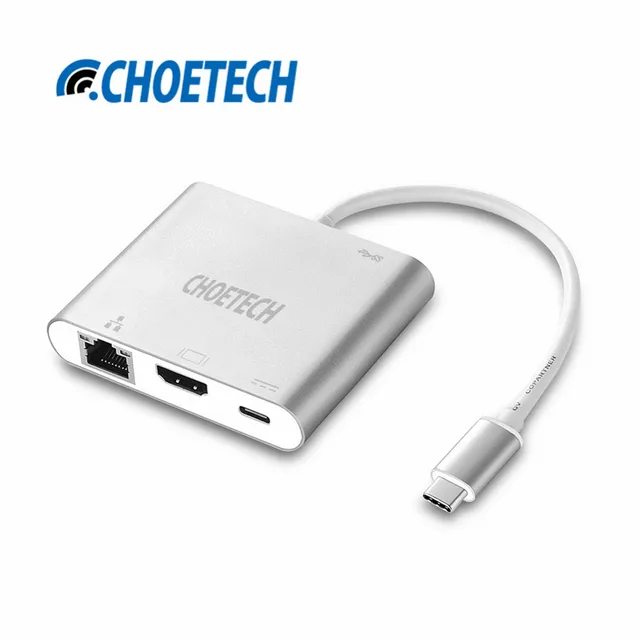

  • You should buy an adapter like this:
    Resultado de imagem para adaptador thunderbolt usb c
    However, I'm not 100% sure if it will detect the monitor!
                                                     egydiocoelho Trailblazer
  • SilfverA
    SilfverA Member Posts: 6 New User
    Well, i guess i have to visit som shop tomorrow and buy some kind of adapter or dockingstation. Thank you so much for the help
