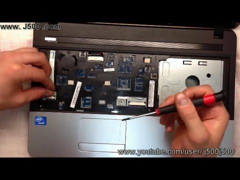

I spilled water on my keyboard.  I got a replacement keyboard, removed the top and now am lost.  There are 4 cables.  Left is power button.  Middle bottom is touchpsd. Right is keyboard.  The two wire cable connects with red wire on right.  Touchpad and keyboard cables connect through front and latch pulls down.
Let me know if any of the above is wrong.  No matter how I connect the power button cable I do not get a display.  Does the blue tab lead, or folld behind?
Does it connect from the back, the top or the front?  Does the blue tab face towards the front, back, top or bottom?
How much to replace keyboard and motherboard if I provide parts?  I broke the keyboard cable clip.
Thanks for the help.

    Hi,
    Have you hand tighten all screws before trying to start? Anyway, see whether attached video help you, you could also try getting help from a local repair shop near you about the price for replacing the keyboard or if you want the Acer Service centre to fix it, please contact:https://www.acer.com/ac/en/US/content/service-contact
    https://www.youtube.com/watch?v=p49TyX-HdrE
