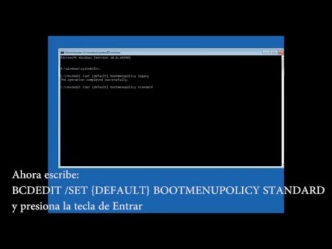

    I would now try to update the drivers for the latest versions! I usually use the driverbooster program only in an emergency situation. Make sure the driverbooster solves your problem. No need to download the dashlane or gaming software: https://download.cnet.com/Driver-Booster/3001-18513_4-75992725.html?part=dl-
    If that does not resolve, check out this video: https://www.youtube.com/watch?v=C18BzcuhNkM
