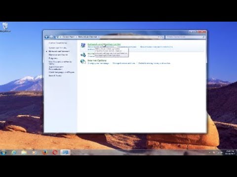

    In 1 YouTube video, there was a suggestion to install Wifi drivers in Windows 10.  In Linux Mint the Driver Manager automatically downloads the correct drivers for your laptop (they are marked as "Recommended").  Trying reinstalling.
    In this video, also for Windows 10, the suggestion is to turn off a power saver option.  Your Power Manager may have a similar option.
    https://www.youtube.com/watch?v=syG7wbp-6aQ
    As far as drivers are concerned, Ubuntu offers the drivers which are in the kernel, so there are no special drivers to use. Acer doesn't make linux drivers as far as I know.
    The power saving route is interesting though! I'm gonna check that out, I hope it's something that simple. Thanks for this tip!
