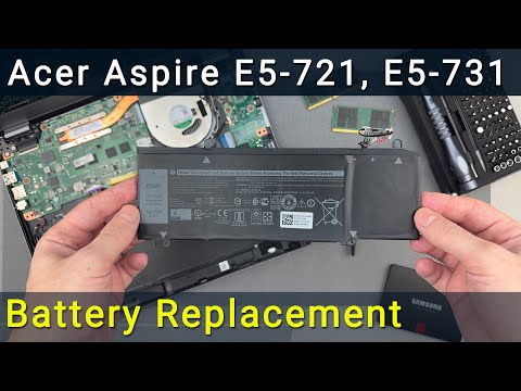

  • To get access to the battery as @JackE! Remove the screws and remove the DVD! Then follow these steps to gain access to the battery:

    https://www.youtube.com/watch?v=Z9L9xTOhRk8   You must remove the bottom case as in the aforementioned video to access the battery. The battery is less than $20 with free shipping from Amazon. Jack E/NJ
