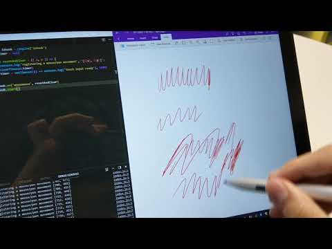

A longstanding issue which I'm frequently encourtering is that everytime I draw something on OneNote using a pen I can't immediately scroll / drag the page, because the touch somehow doesn't work. It boots up after a while. This is not related to a pen, as I did test with other supported pens (MPP based pens, like Surface Pen or Adonit Ink).

Recorded a short video demonstrating the issue. In the second half of the video I decided to write a test app to prove the existence of the bug.
https://www.youtube.com/watch?v=5oHrTjZ2aUgWould be happy to see a firmware update fixing this annoying bug.
