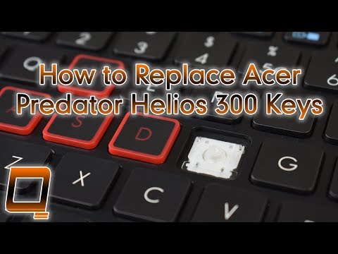

    You can try taking the key off and cleaning whatever is inside of it out or perhaps its not seated properly?
    This video has a quick straight forward method of removing and replacing the keys.
    Hope it helps.. 👍
    https://youtu.be/VhgqP0zu3OU

    Yep it helped, I have put the plastic thingy out, cleaned and reassembled it. Now it works fine again. Thanks ^^
