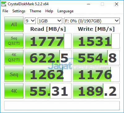

    Could you post only the PCI Express Root Port 1 highlighted snip, showing the maximum link width, so far I couldn't find anyone with NVMe SSD installed in this model, so I am a bit sceptical whether it would work, however if you buy from a retailer who has good returns policy, you could try and will be the first to install successfully in this model, you have a PCI Express root port 1 with a 4x maximum link width but unable to read the details as it's switching to other ports.
    EDIT: I have found a E5-476G with a NVMe SSD, so you may be able to try a M.2 NVMe SSD.
    http://www.jagatreview.com/2018/01/review-acer-aspire-e5-476g-laptop-murah-untuk-gaming-editing/2/

    looks supported, but the speed is slower than usual. i better buy evo 850 m.2 like suggestions to save my money. thanks =)
