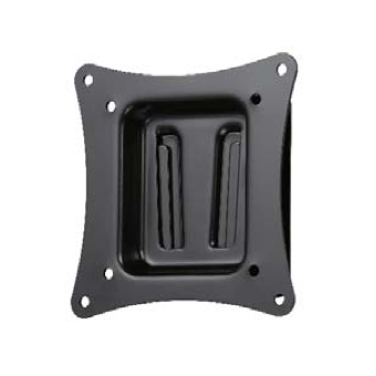

 Is there an acer specific vesa mount or adapter for the Z35, once you remove the stand.
I have VESA mounts that are 100 x 100 but won't fit due to the depth of the vesa mount location
Or did i miss something.
I did purchase the monitor used however
Thanks
Mike

    Hi - actually I have the following
    RSeat for SImulator
    Thanks

  • You could use this kind of system  (spacer) between the monitor  and the plate of your stand. May be board spacers. You find these products in the electronic shops.

    Found this and it works perfectly with the Z35
    https://www.amazon.com/VideoSecu-Adjustable-Rotation-Bracket-Monitor/dp/B0016CDE0E/ref=sr_1_1?ie=UTF8&qid=1474926279&sr=8-1&keywords=videosecu+ml411b
    Thanks again for all the suggestions
    Michael

    center of hole to center of hole 2.25" (inches)
    Hope this helps -
    I didnt have to do anyhthing to get it to fit my Rseat Monitor stand but I probably should have
    its VERY close - but it works - I could have used a dremel or such to take of a tiny bit but i was
    lazy when i didn't have to
    Mike

    Thanks for the photos. That sure is one uneven recess. I'm not even sure what size VESA spacer to get to mount it with a telescopic ceiling mount (the latter of which seem to not have a "100x100-only" option, i.e. they go up to 200x200).
