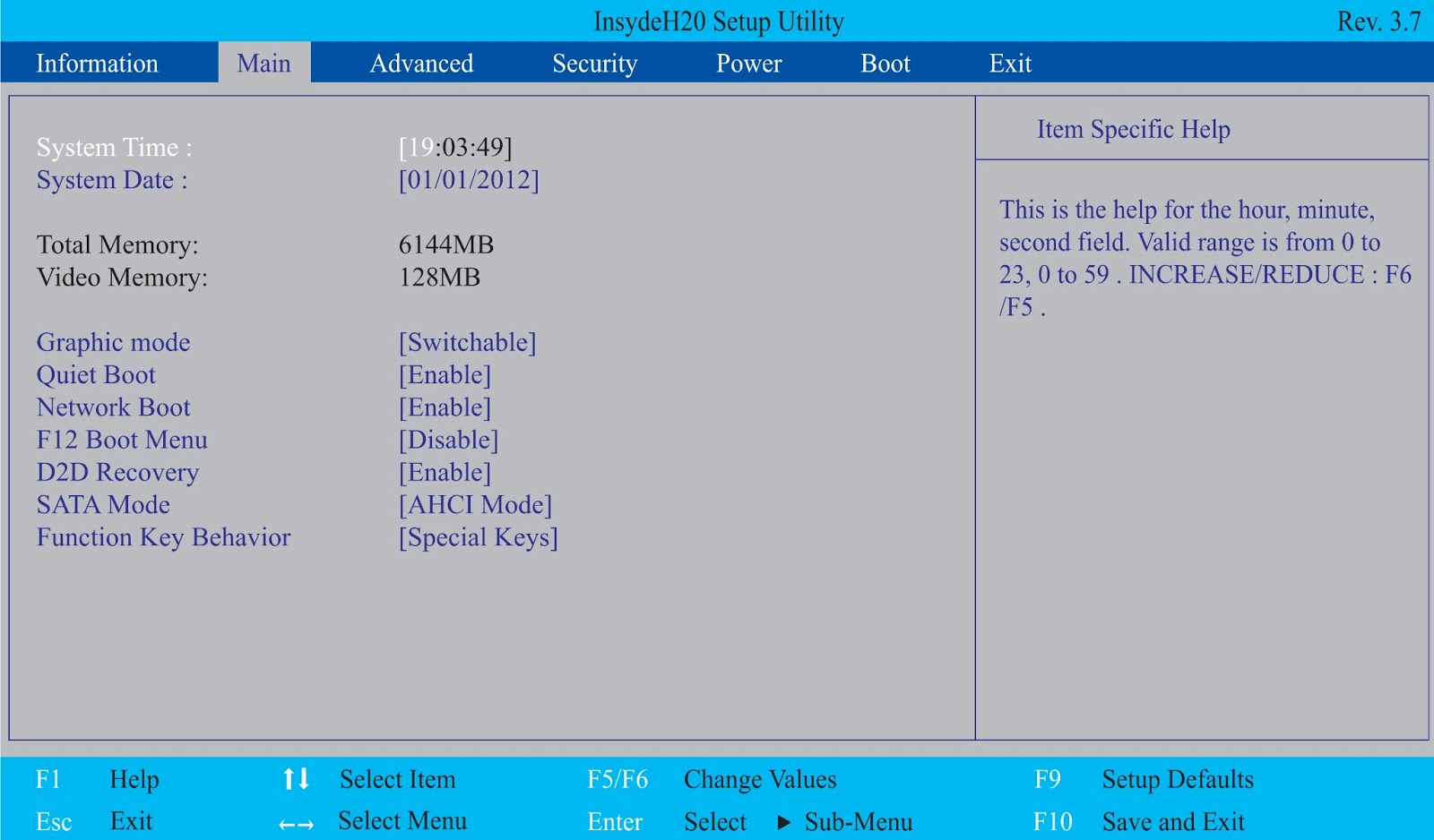

    1. As you have suggested, I’ve hold press the  <F2> during power on during system start up but it’s has a long beep sound and continues to load Windows 8.1…
      Repeated a few time power shutdown and same results. Google search found a suggestion by press <Shift Key> and mouse click the Shutdown, then select the Power-Off PC option to shutdown completely, re-power on again immediately BIOS utility menu shows up, checked the Main Tab and  found the <Quiet Boot> option is set to <Enable>.
      However, I had forgotten to book-marked the page so I could not retrieved this suggestion but I suppose this is a way to enter BIOS setup? Meanwhile I’ll continue to search hope to find this page again….(*But I am Not too sure this is the right solution? As my V3-471G is an older motherboard bought just a month before Windows 8.0 pre-installed version which support the BIOS version 2.XX c/w a UEFI sub-menu. There are two type motherboards for V3-471G model, BIOS version 1.XX and 2.XX)
      *P/S Note: I’ve tried to follow the previously email suggestion from Acer Support Centre to enter in BIOS menu and select "Load Default Settings", double check Bluetooth setting in Device Manager….but somehow I realised the above problem when I tried to enter BIOS menu but failed because of Windows 8.1 did not showed Acer Logo + <F2> BIOS option anymore?

    Hi again KcOh,
    So if I'm no mistaken, your Bluetooth problem is fully fixed now? I know it can be a pain but I'm afraid going to PC Settings is the only way to <Enable> or <Disable> Bluetooth from now onwards. Acer Launch Manager works better under Windows 8 but the new 8.1 update just broke it. I'm almost certain it's simply a case of bad coding because most other manfcaturers have proper Launch Managers were the OSD shows up properly when pressing the <Fn> key.
    As for your first complaint, I think I figured it out. And it has nothing to do with the BIOS version, I have version 1.XX too and it's working fine with Windows 8.1. Your problem I believe is the "fast start-up" as Microsoft calls it which is basically basically a Hybrid shutdown in which the system doesn't Fully Power Off. This bsically speeds up the bootup process but it means you never get access to the BIOS anymore because it just skips it. Here's what I want you to do:
    1. Click on the battery icon on the bottom-right corner of the screen and click on More Power Options.
    2. Click on Choose what the power buttons do on the top-left corner of the screen.
    3. Scroll down and you should find an option like this: Power Options
    4. Uncheck the fast startup and restart your laptop. You should see the BIOS menu henceforth.
    Let me know if you need more assistance.

    That's weird... It shouldn't boot this quickly once you've disabled the fast-boot setting. UEFI BIOS can boot this quickly though but your BIOS I understand is version 1.XX so it cannot have UEFI. Are you holding the F2 key or tapping it? I need you to tap the F2 key as quickly as possible,repeatedly the moment you press the power-on button.
    Otherwise, try pressing the Win+C to bring up charms and then click on the power icon and press on shift while clicking restart. This should in theory emmulate a cold reboot and show up the BIOS. May I ask what is it that you require changing in the BIOS Menu?

    Thanks and it was an email suggestion by Acer Service Centre support to enter BIOS menu to select <Load Default Settings> and check option to enable Bluetooth before re-boot Windows 8.1, from there I had realized the different between the Legacy BIOS v1.XX and UEFI BIOS v2.XX (*System shipped with Windows 7 c/w BIOS v1.XX & Windows 8.0 c/w BIOS v2.XX), before this I did not have any knowledge of Microsoft has mandated the UEFI implementation for all Windows 8.0 based systems, this could has been less pains if I come to this Acer Community early, instead of taken the e-recovery Windows 7 route and reverted to factory default setting!
    Yes, after I had made changed on Power Options >> Uncheck the fast startup setting and restart, then initial screen of <Acer Logo + F2 for BIOS > did appeared, but by holding the F2 key will have long beep sound and continues to load Windows 8.1…I had also tried restart by tap the F2 key quickly without press the Shift key has the same result of Windows 8.1 continue loading…
    As you’ve suggested to emulate a cold reboot (*press on Shift Key while clicking restart) and BIOS menu displayed immediately.  In addition I had tried by press on Shift Key + clicking power off, Re-power on system and quick tap F2 key will also show up the BIOS menu. Perhaps here I could concludes that by press on <Shift Key + Restart> or <Shift Key + Power Off> will bring back the BIOS menu.
