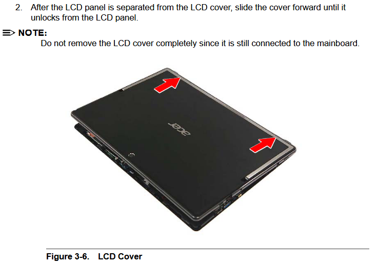

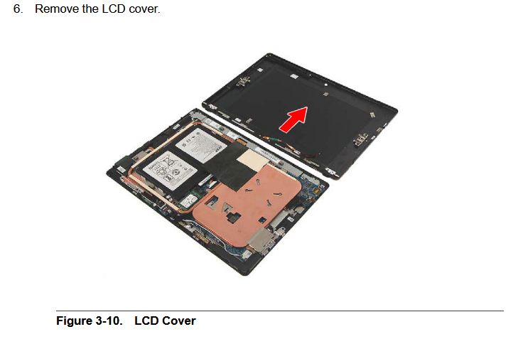

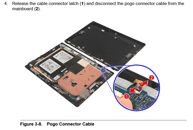

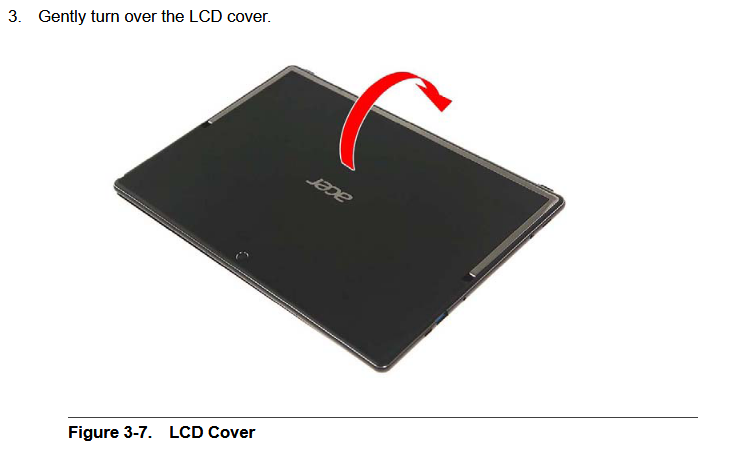

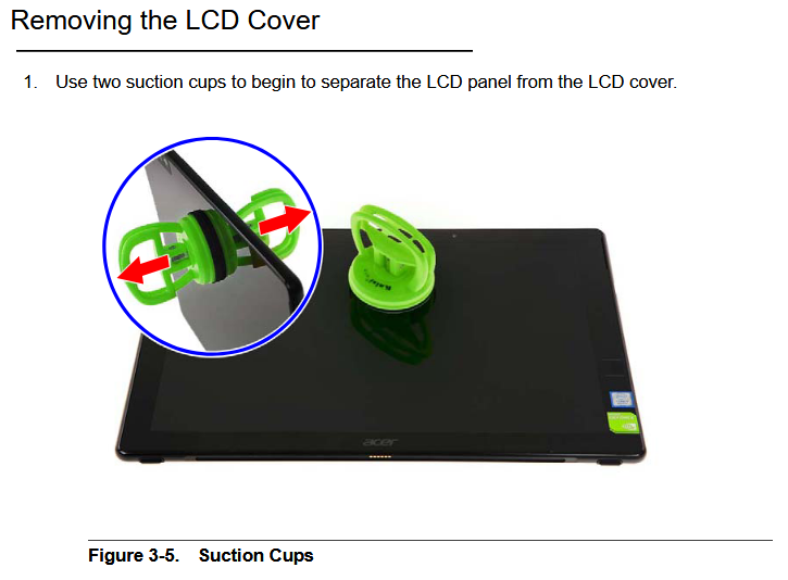

Re: Acer Switch 7 SW713-51GNP No HDD after Windows update : I got a no bootable device message
There are a couple of possibilities, but with the BIOS showing no drive it's pretty much narrowed down to the drive has failed. It's a bit of a pain to get the Switch 7 Black Edition apart, but once apart replacing the drive isn't too difficult. The drive is an M.2 form factor SATA drive and the design is just old enough that the newer NVMe drives aren't supported. You can use whatever size you prefer for the drive itself, there is no practical limit, other than your pocketbook.
At that point you have access to the SSD, which is shown on that last image between the big copper shield and the heat pipe (small rectangular white label on the top of the drive). Note that the drive can only be one form factor, a 2242 or 2260, measure to be sure. The more common 2280 drives will not fit the space.
billsey
