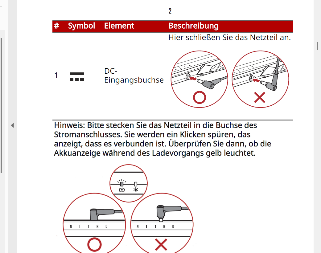

    Can you please post the exact model of your laptop? Is it a new one?
    You haven't posted any information (for example if the LEDs are lighting, if you hear the fan, etc.), so nobody can limit the possible reasons.
    Are you sure that the plug is connected correctly?
